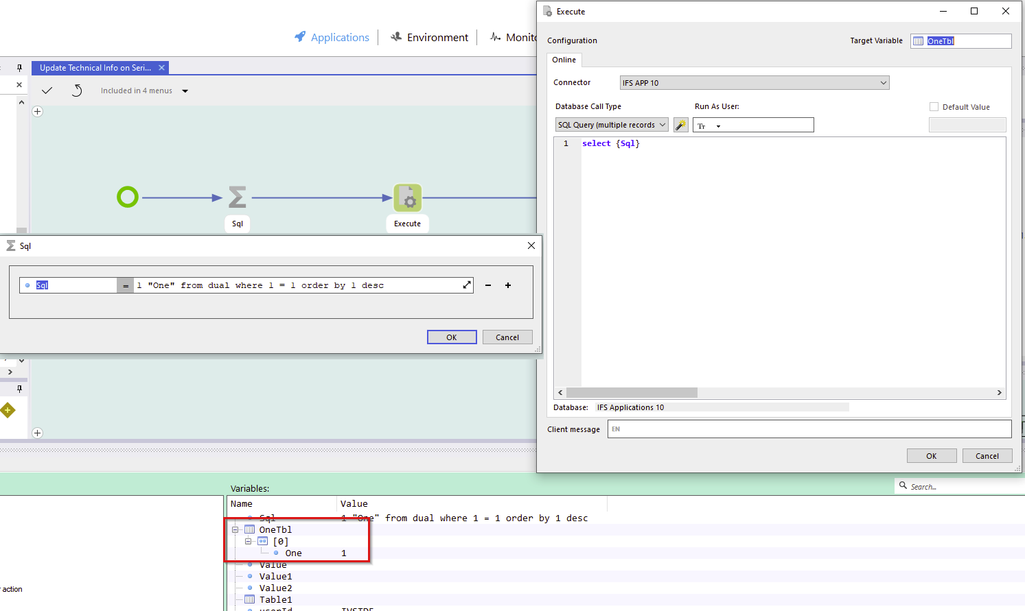

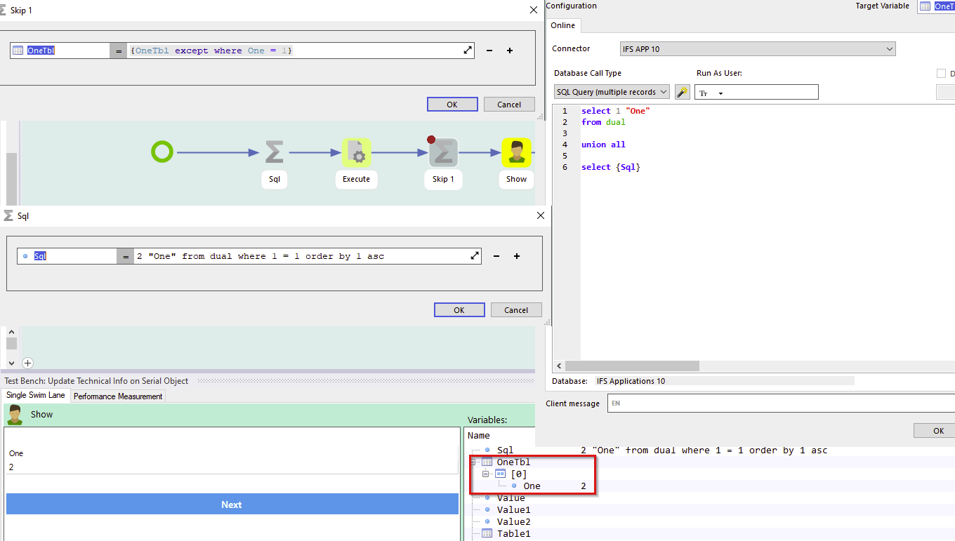

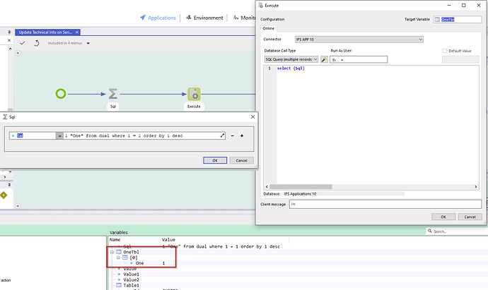

Hi,
yes as Johannes said, whole sql code can go in a variable and can be used with {} in machine steps.
The problem is Flow realizing what you selected while you build your app (you can simply select {Sql} and it will fetch it but due to Flow validation you wont be able to use it down the line)
So what i did is “initialize” the variables in the same machine step and then UNION ALL it to my constructed Sql and then just removed that init row in assignment step:
Hope this helps!
