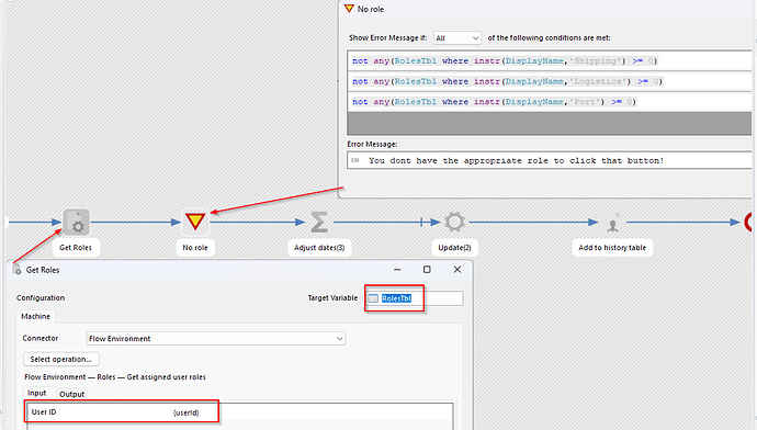

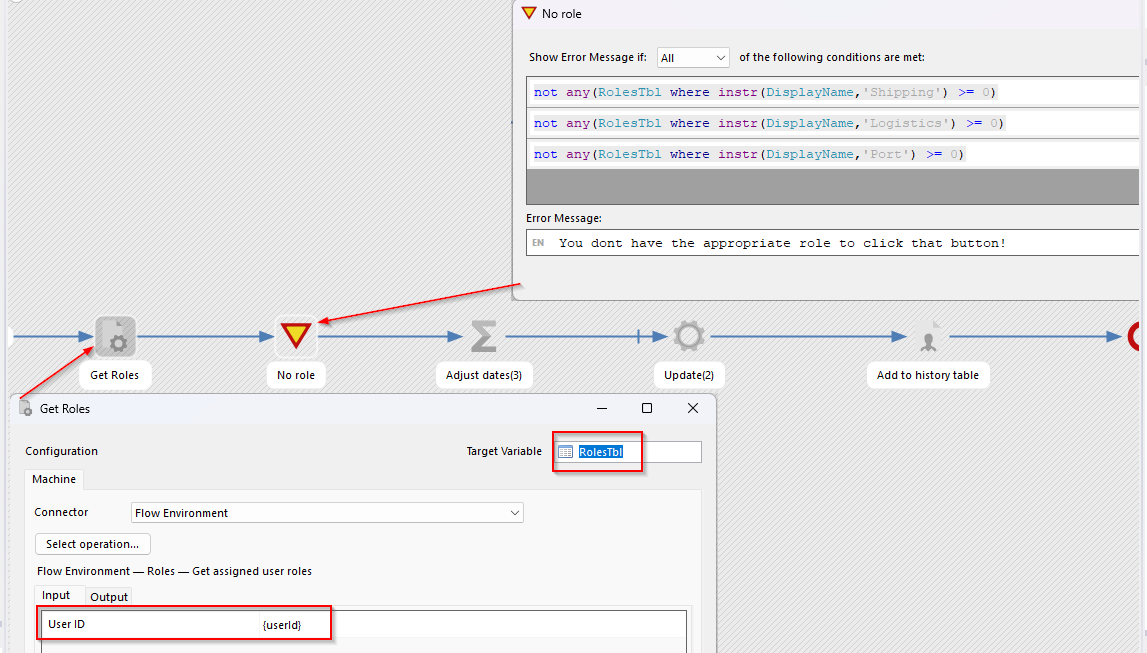

Hi,
i have used the environment connector to first fetch the roles for a user and then script / decision /assertion steps to restrict access / execution based on a role.
For example this is for a button in portal:
(Maybe not the most performance optimal way…but it works…and if it works…you know :slight_smile: )

Ah…missed the flow connect tag…well…just gonna leave the post here, maybe it helps someone who misses the tag looking for Flow Classic fix :slight_smile:
