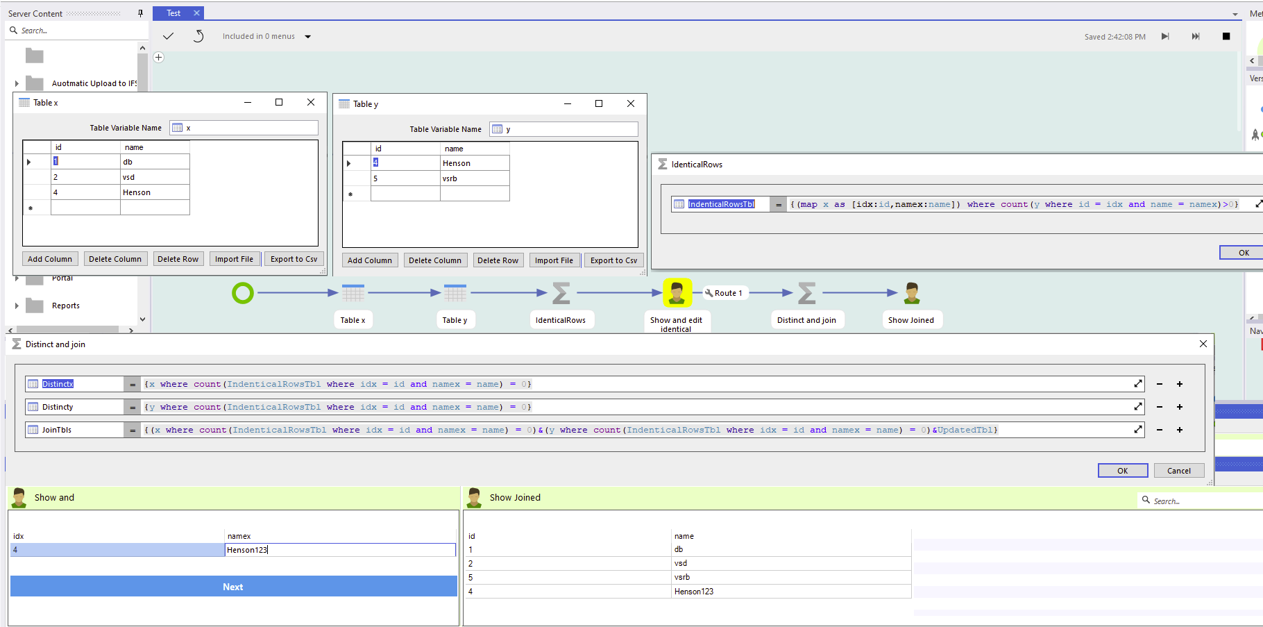

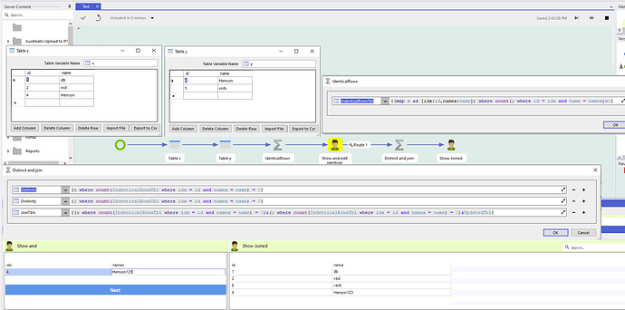

Hi,
(not sure if its the most performance optimal way but…) this should work:
Hope this helps!
B R
Ivan
Test.flow (187.8 KB)
