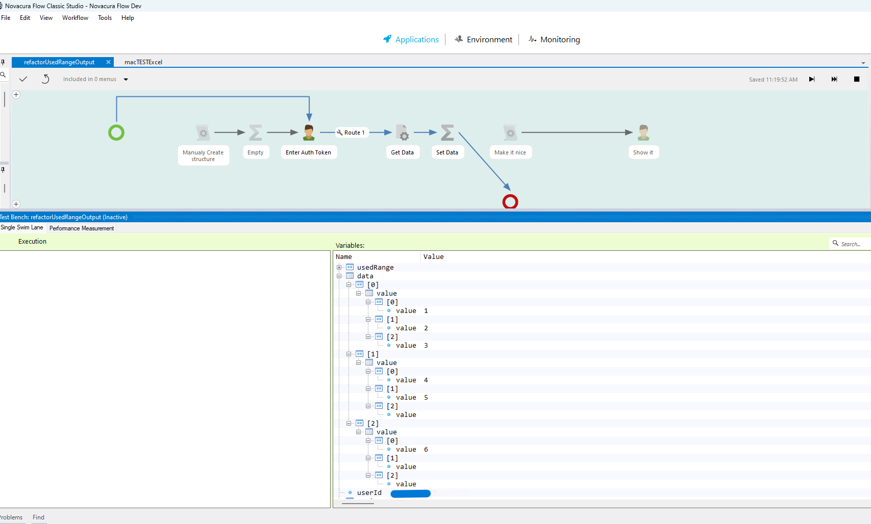

Hi again,
what do you get if you feed it this:
(I am guessing: “data” table with 3 rows, each row containing a “value” table with table in first row having 3 rows (column “value” = 1, 2 ,3), table in the second row having 2 rows (column “value” = 4, 5) and table in the third having 1 row (column “value” = 6))
B R
Ivan
Hello, this is what that looks like in my output:

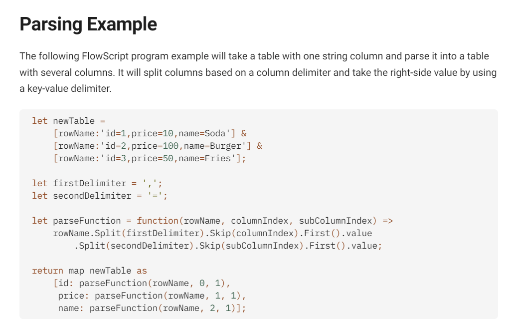

Another solution for “flattening” your sub tables would be something like the Parsing Example from here Programs | Flow Help

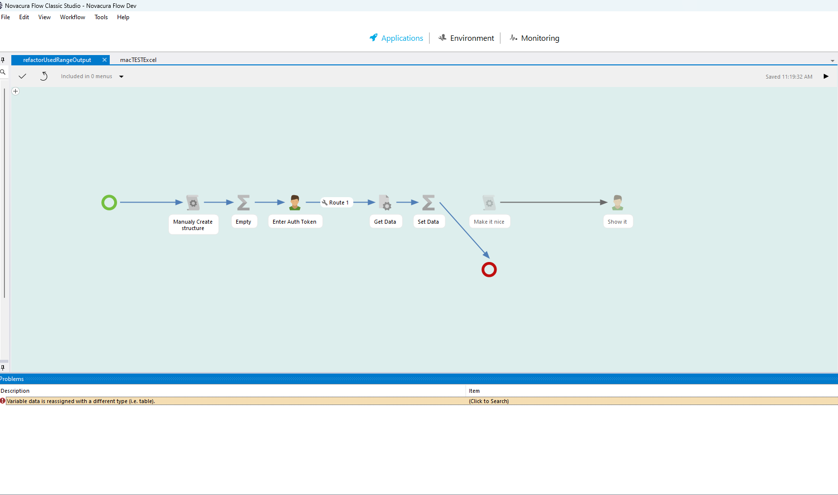

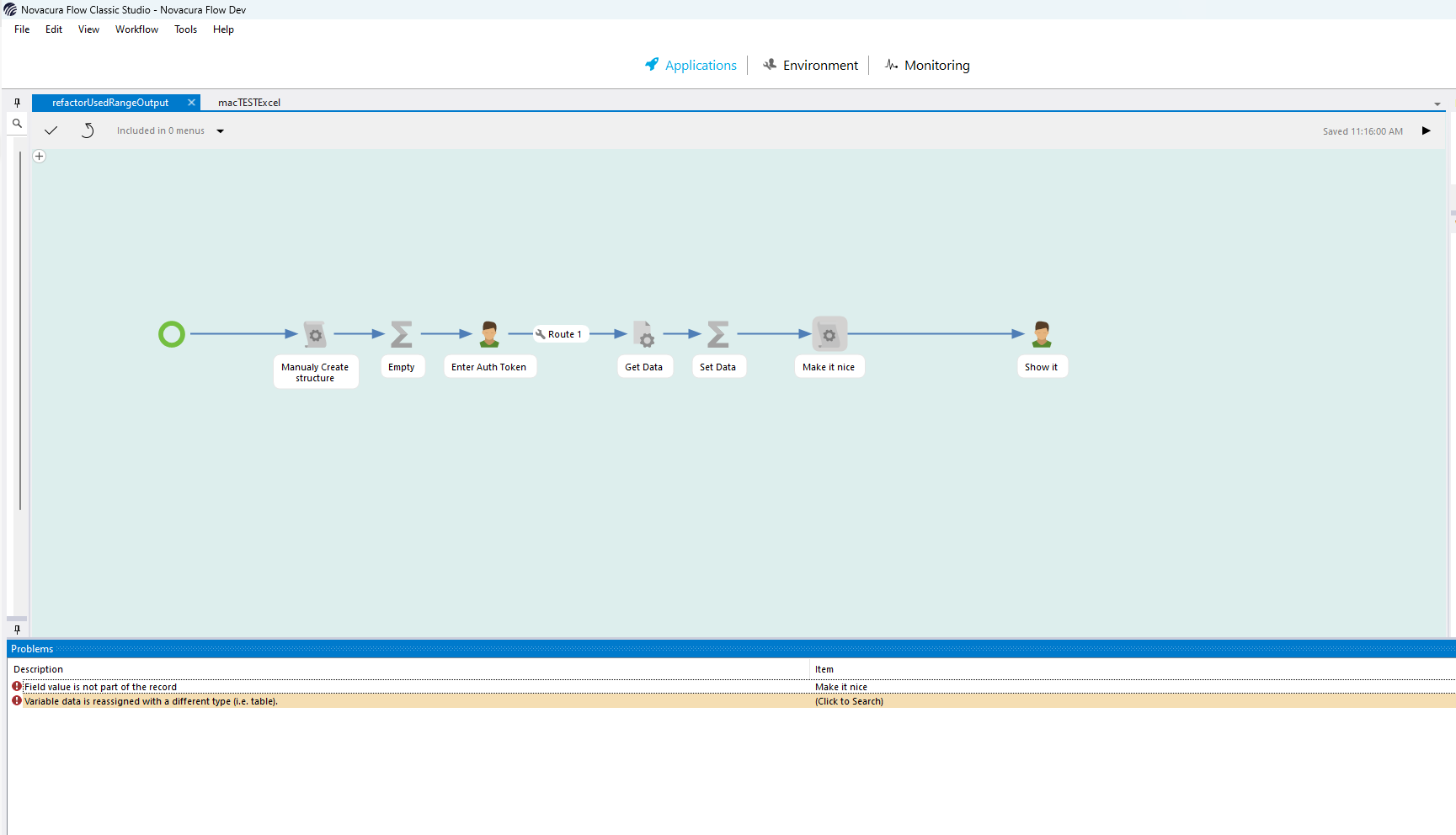

Hello,
I am trying to implement your solution but am running into an issue. Although the table you created and the table, I am testing with are identical in the output, the flow will not run due to an error in the script step to “make it nice”. As you can see in the screenshots below, row.value is not recognized, although it would make since that it is. Row. wants to autofill to row.table however this does not work either. Any further help would be appreciated. I figured out I can go further in the last screenshot. However, “Val” does not work. Novacura tells me it expects a type. I tried with table(value) and a few other iterations, but this does not work and results in the same error message.

i am confused…don’t understand why it wouldn’t work if the data structures match…(its not version related, just installed that version and my example still works there).
Maybe you can try and leave my script for creating the structure then just add an assignment step after to empty the values (but the data table structure should still be initialized)
Then add your REST call step after and see if the “Make it nice” script step gives you errors?
(or if it would be the REST call machine step that would complain about something)

Hello,
I have tried what you asked. I am unsure of what the issue is. Here are some screenshots.
Best,
Andrew
