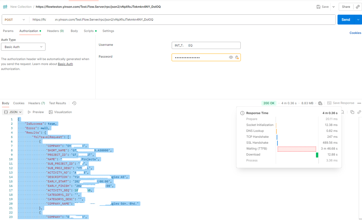

POSTMAN - 4 minutes (previously noticed during peak hours around 7 mins)

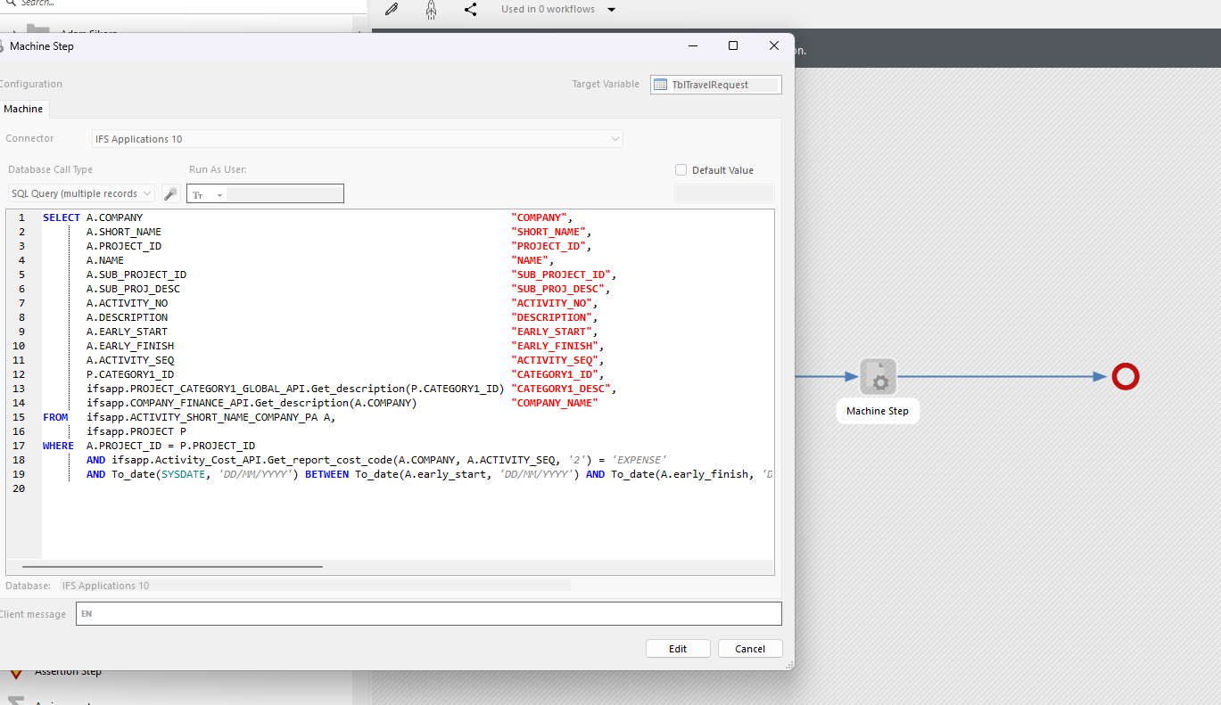

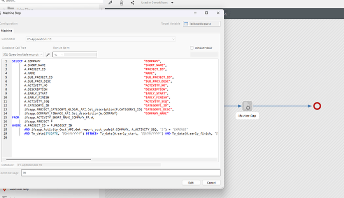

Is the PL/SQL tool installed locally on your PC? And you are running the exact same query (character by character) inside only one machine step against the same database? And not using the iterator or anything like that in the machine step. Perhaps some screenshots to help us understand the setup?

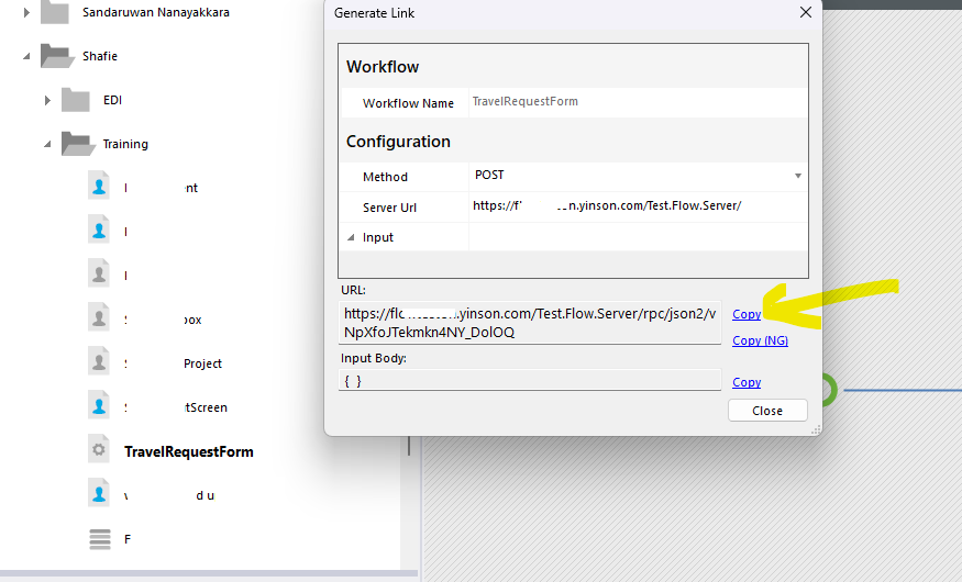

And can you explain how you use Postman? Have you created an API against the DB, or are you using IFS OData or something? I guess the back-end SQL query might be built a little differently, and if nothing else, executed on a server closer to the Oracle server?

yes PL/SQL tool is installed locally on your PC (postman, novacura classic, all tools are installed locally) and running the exact same query (copy paste). i have attached some images on postman and web URL(API) please check.
Hi, The connector, it is not directly against Oracle if I read it correctly, but via IFS Application layer? On the connector, it is the IFS Application layers url right, not the oracle server?
I think that might explain the difference.
