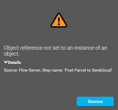

"Object reference not set to an instance of an object." in POST request at REST API

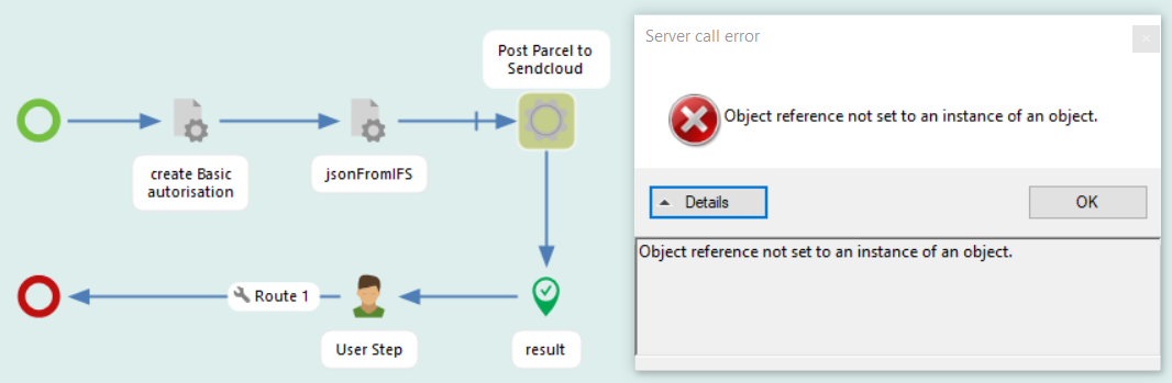

This POST request was working well until the REST-connector was extended with a GET-model in the REST-connector.
We don’t know where to look for a solution.
And in the browser client:

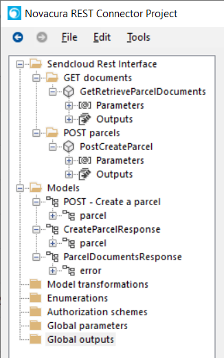

Hi, that is a very generic error message. I see you are saving the calls to a log file. Does that indicate anything of value?
Cann’t find a clue.
The files in the connector log directory are called *_Request.txt and *_Response.txt.
I guess this error is thrown before the request can be made.
Would be requested then. However, the error message indicates that you had something in the model that no longer exists. Typically, if you created the project, used it in some flows, and then removed things from the model.
Perhaps try creating a model from scratch for testing? And also, be sure to always use that refresh button in the machine step to get the latest version of the model.
